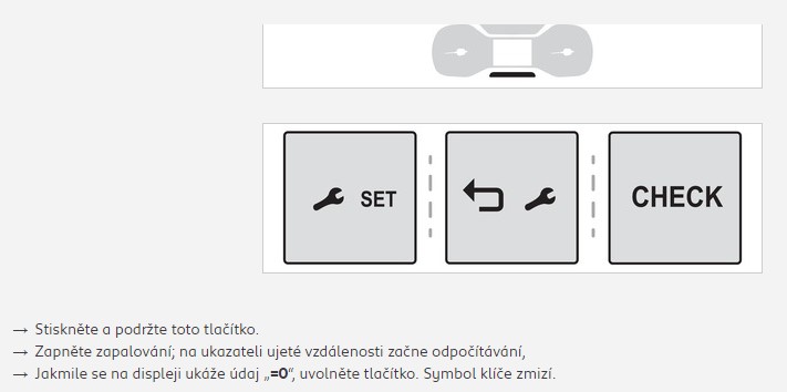

mmartinkovic 662 Posted December 18, 2020 Share Posted December 18, 2020 Bud diagnostika, pripadne aj od nejakeho clena, ale reset intervalu sa da tusim pridrzanim nulovania km na 10sek. Quote Link to post Share on other sites
jarokare 3,216 Posted December 18, 2020 Share Posted December 18, 2020 Zas jeden , co nečte návody tam se dozvíš věcí ... Celej návod zde http://public.servicebox.peugeot.com/APddb/ a na změnu intervalu je třeba diagnostika radim.1008 and mmartinkovic 2 Quote Link to post Share on other sites
gom_18 1 Posted December 23, 2020 Author Share Posted December 23, 2020 Nádhera, projel sem manuál co sem k vozu dostal a nenašel nicméně díky. Quote Link to post Share on other sites
