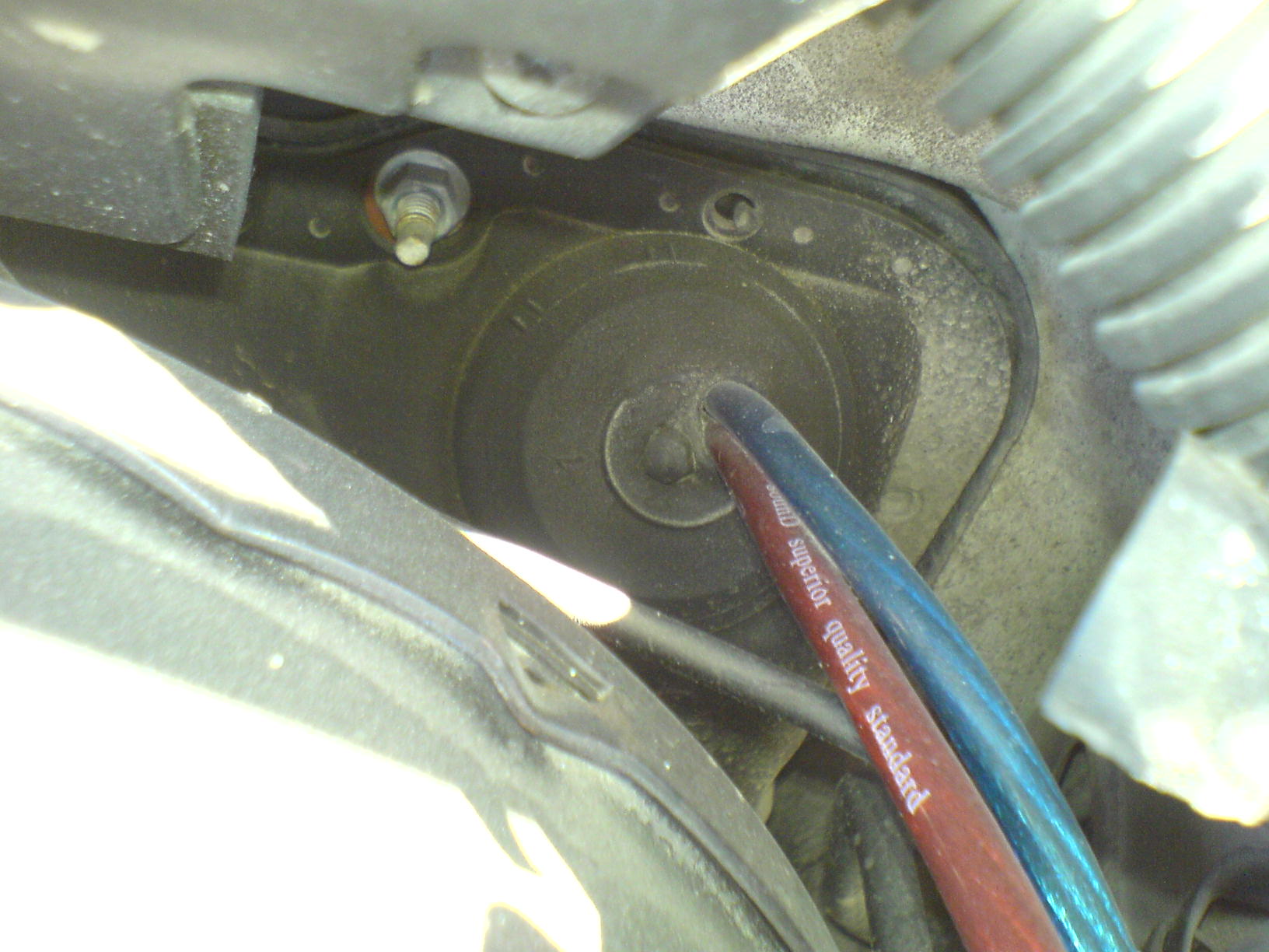

Ferry Posted April 11, 2007 Share Posted April 11, 2007 ja mam kabely od systemu LPG protazeny takovym cernym plastem, kterym prochazi trubky od topeni ( je to vedle brzdoveho valce ) normalne provrtana dira 6kou vrtakem, pouzil jsem ji i ted pri montazi alarmu prave k protazeni kabelu od sireny Quote Link to comment Share on other sites More sharing options...

Yeti Posted April 14, 2007 Share Posted April 14, 2007 tahal som kable vedla brzdoveho valca Quote Link to comment Share on other sites More sharing options...
buml Posted April 14, 2007 Share Posted April 14, 2007 Stejne jako Yeti, dobrej pristup z obou stran a vejde se tam toho dost :-) Quote Link to comment Share on other sites More sharing options...
