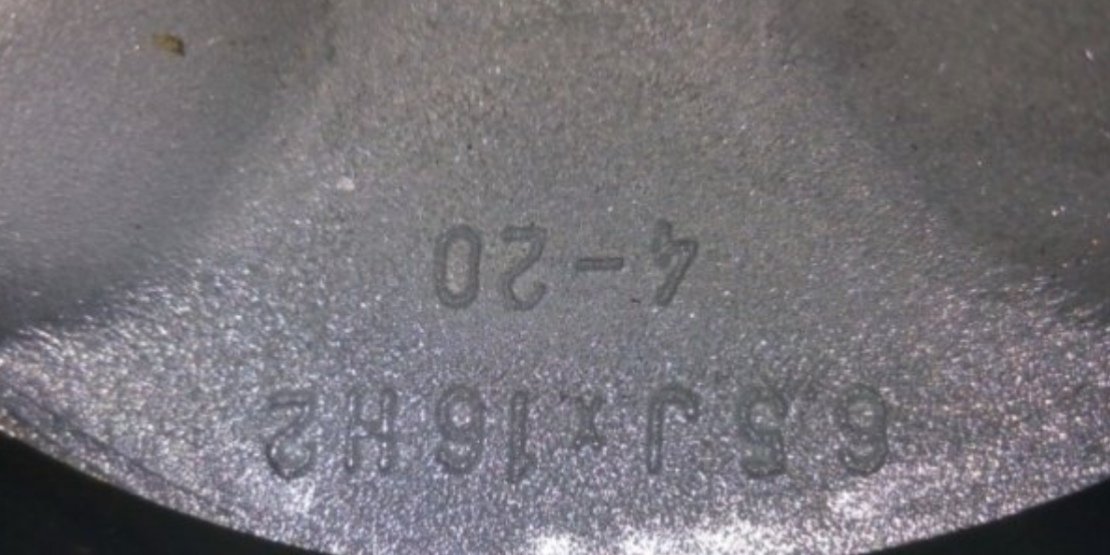

Lukas.407 Posted April 5, 2019 Author Posted April 5, 2019 (edited) Aha, ja kola jeste nevidel. Psal mi et 20 a poslal tuto fotku, nevim ani jestli toto cislo je cislo et... V oznaceni na kolech se moc nevyznam. Ale pokud je origo et31, tak ani tech eventualnich et20 neni uplne tak hrozny a et28 uplne v klidu. Dekuji za radu Edited April 9, 2019 by Lukas.407 Quote

brutall Posted April 6, 2019 Posted April 6, 2019 Na tu 307dmu jsem psal "asi" 39, je to ET 31. Na Ouraganech je pro 406tku ET 20 a na 206tku je ET 28. Obě jsou to šestnáctky. Lukas.407, MilanF1 and 307rg 3 Quote

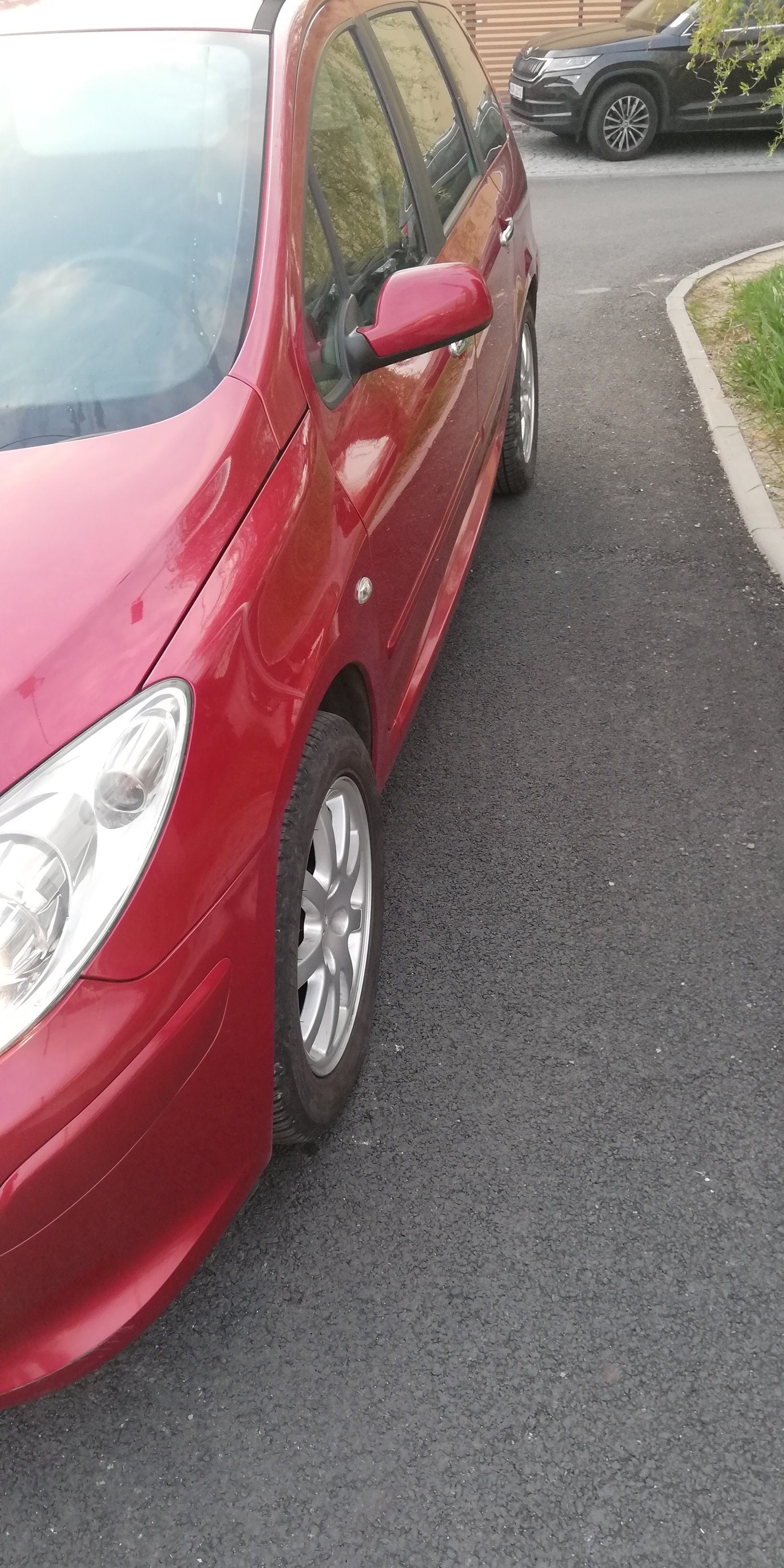

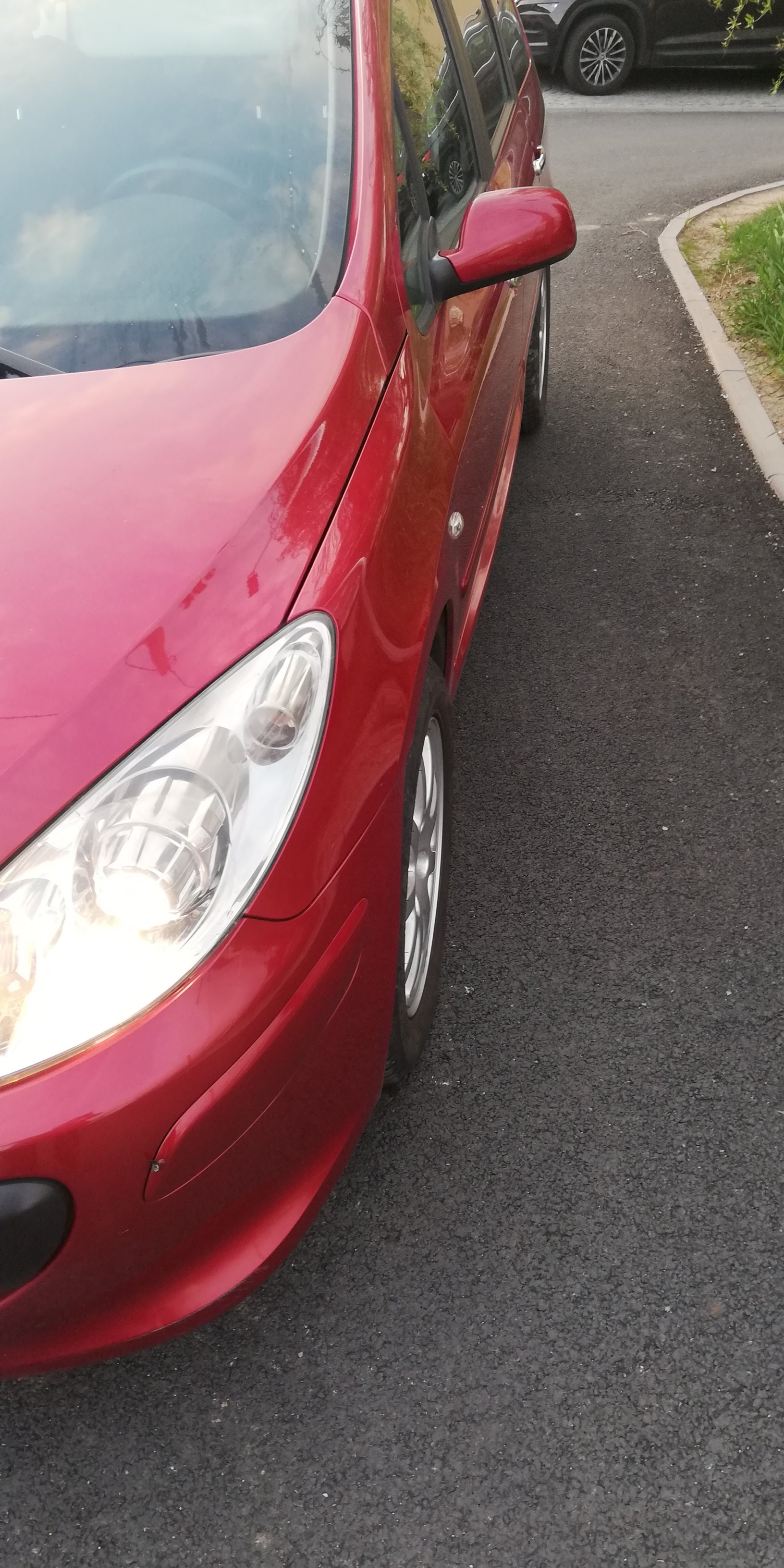

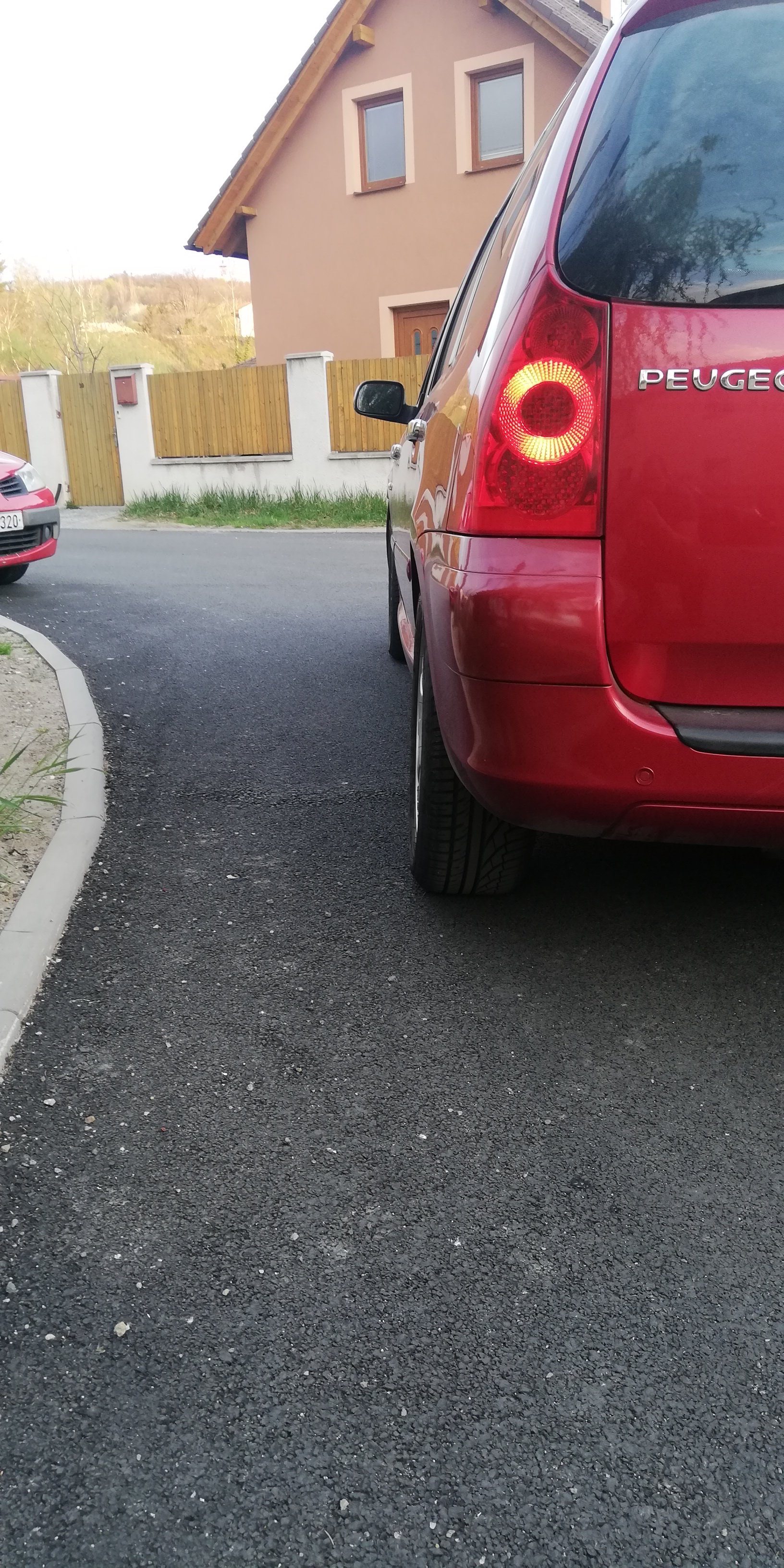

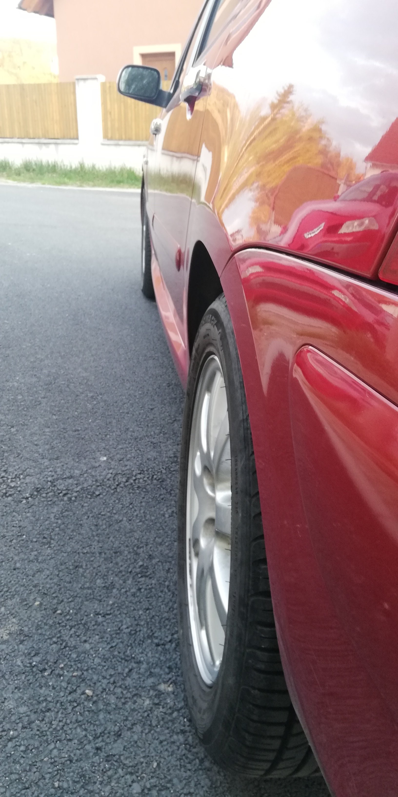

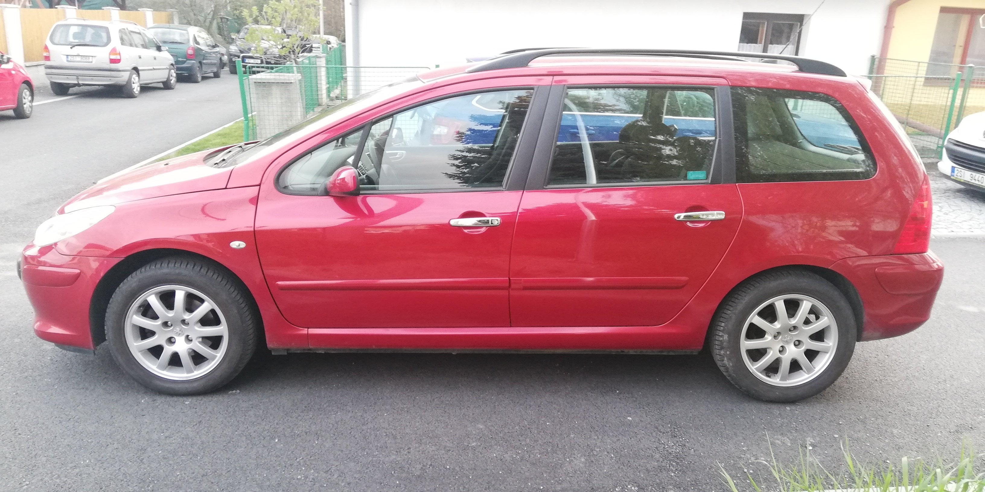

Lukas.407 Posted April 6, 2019 Author Posted April 6, 2019 Tak maji et 20. Dali jsme je na auto a je to uplne v pohode. Bal jsem se toho vic. Quote
Lukas.407 Posted April 6, 2019 Author Posted April 6, 2019 (edited) Urcite, vecer doplnim Edited April 6, 2019 by Lukas.407 brutall and MilanF1 2 Quote
Lukas.407 Posted April 6, 2019 Author Posted April 6, 2019 Taky si myslim... A kola jsou porad v blatnikach, takze nehrozi ani dreni o lemy. Quote
