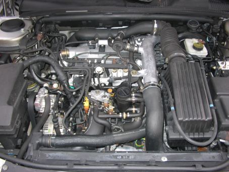

Miku Posted March 25, 2007 Share Posted March 25, 2007 tady máš foto motoru 2.O Turbo [upravil dne 25.3.07 Miku] [upravil dne 25.3.07 Miku] Quote Link to comment Share on other sites More sharing options...
Miku Posted March 25, 2007 Share Posted March 25, 2007 pro Tomi: jak psal již Ferry jedná se o osmi ventil typ XU10J2CTE 15O koníků /5500ot. , 235 Nm/2500 ot. Jinak jsou tady borci co ho mají poladěný Quote Link to comment Share on other sites More sharing options...
