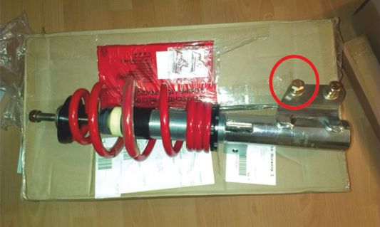

shark734 Posted March 10, 2013 Share Posted March 10, 2013 zdravim pani, menil som tlmice no v mieste zakruzkovanom na obrazku je podlhovasta diera, cize sa da nastavovat odklon kolies. Budu mi to vedet na geometrii nastavit? Bude to drzat na mieste, alebo mam vymyslet ako to upevnit? vdaka Quote Link to comment Share on other sites More sharing options...
mxmen Posted March 10, 2013 Share Posted March 10, 2013 na geometrii to nastaví určitě Quote Link to comment Share on other sites More sharing options...
ozzy56 Posted March 10, 2013 Share Posted March 10, 2013 nastaví, pokud jim dáš hodnoty..., co vím, tak mají ve stroji jen standartní hodnoty Quote Link to comment Share on other sites More sharing options...
shark734 Posted March 10, 2013 Author Share Posted March 10, 2013 dakujem, nebude to treba este nejako zaistit? MHS mal problem, ze pri plnom rejde s prudkym rozbehom sa mu to rozladilo. Quote Link to comment Share on other sites More sharing options...
ozzy56 Posted March 10, 2013 Share Posted March 10, 2013 všechno by mělo být součástí sady tlumičů Quote Link to comment Share on other sites More sharing options...
shark734 Posted March 10, 2013 Author Share Posted March 10, 2013 nic ine tam nieje, na origo tlmicoch je tam len diera presne na priemer skrutky Quote Link to comment Share on other sites More sharing options...
shark734 Posted March 11, 2013 Author Share Posted March 11, 2013 tak hotovo pani, na geo s tym nemal problem...este raz dakujem a zvlast HonzovyZ za parametre;) Quote Link to comment Share on other sites More sharing options...
