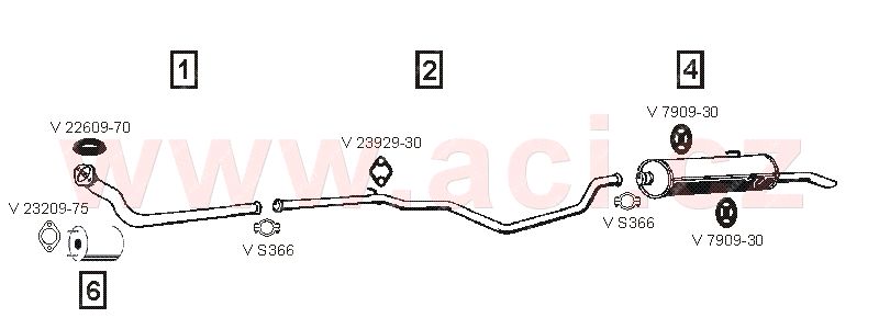

Ty mas hladkeho D-ieslaka a tam by mal byt bud tento vyfuk stredove tlmice maju len benzinaky:papa
405 1.9 D 7/87-11/96 (1905cc, 47/51kW, 64/70hp, mot. XUD9A/XU9Y) Sedan/Kombi
