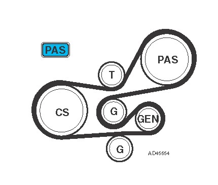

Petricek 0 Posted December 21, 2020 Share Posted December 21, 2020 Zdravim mam 406 2.0 hdi klima poteboval by som vedieť rozmer vonkajšieho remena bez klimy-objednal som remen bez klimy a je dlhší. Klima a bez klimy maju inak rozmiestnené kladky. Neni som pri aute aby som to odmeral vedel by ste mi napísať rozmer remena?dakujem stary co tam bol som nenašiel Quote Link to post Share on other sites
ozzy56 6,482 Posted December 21, 2020 Share Posted December 21, 2020 lepší bude když dáš VIN auta Quote Link to post Share on other sites
čakom 345 Posted December 21, 2020 Share Posted December 21, 2020 2.0 HDI bez klimy 1468 2.0 HDI s klimou 1740, 1744 nebo 1750 Quote Link to post Share on other sites
Petricek 0 Posted December 21, 2020 Author Share Posted December 21, 2020 Ano to viem dakujem ale ten bez klimy je dlhý Quote Link to post Share on other sites
jarokare 3,219 Posted December 21, 2020 Share Posted December 21, 2020 Tak se podívej , jestli ho máš správně nasazenej Quote Link to post Share on other sites
