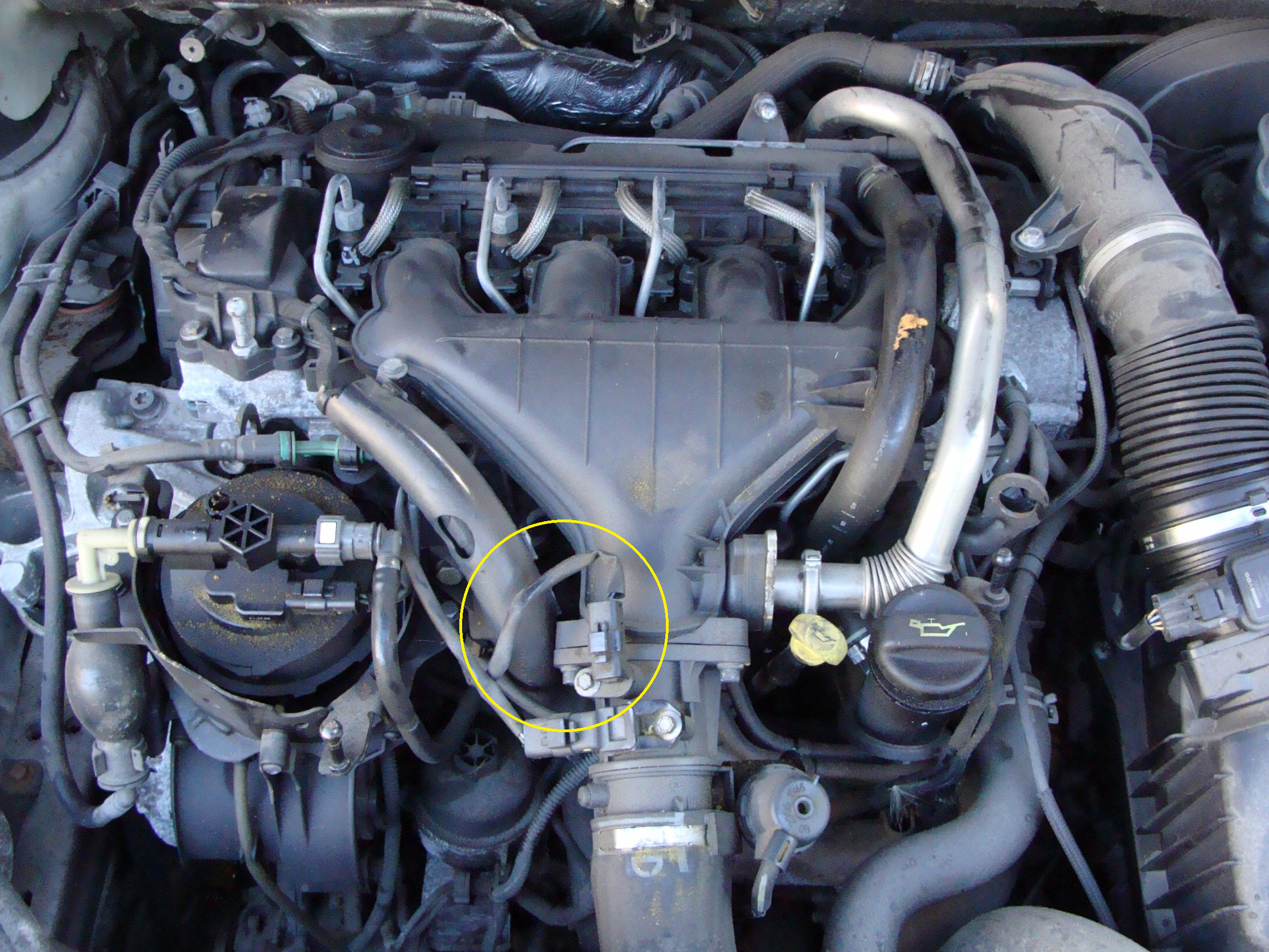

pajik999 Posted March 28, 2019 Posted March 28, 2019 (edited) Jakou chybu napsala dia? Snímač si dával novej ? Tady počti : Edited March 28, 2019 by pajik999 Quote
