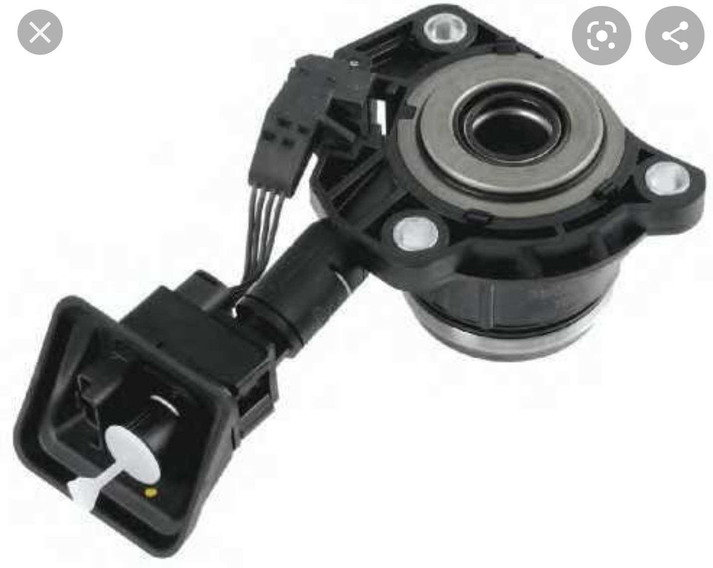

Tomieno 0 Posted April 8 Share Posted April 8 Zotrvacnik bude v prdeli, ten ti rozšlahal spojku. Treba tam objednať aj hydraulické vypínacie ložisko cca 90€. Mal som to isté. Quote Link to post Share on other sites
stankobn 4 Posted April 8 Share Posted April 8 Mas na mysli toto lozisko? Orig. Kod: 2041 A3 ? Quote Link to post Share on other sites
Tomieno 0 Posted April 9 Share Posted April 9 Áno takto podobne to vyzeralo. Mal som aj to poškodené. Quote Link to post Share on other sites
