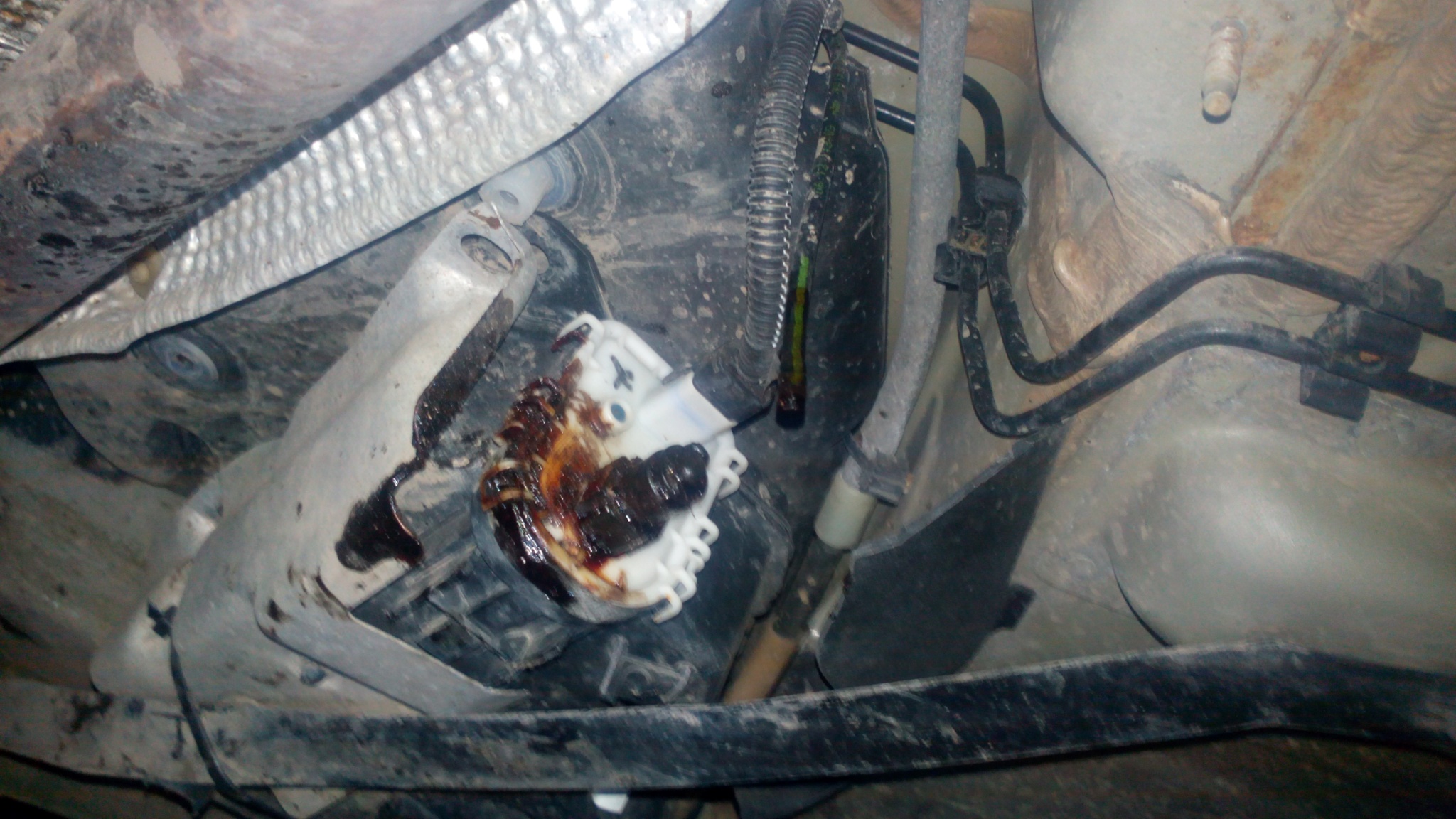

Swop Posted July 22, 2016 Author Share Posted July 22, 2016 Jeste prikladam nove nemile zjisteni. Bylo mi divne ze je nadobka na aditivum trochu ochcana. Tak jsem vlezl pod a hle, tenka hadicka vyskocena viz. prilozene foto. Bohuzel ani nejde nasadit nazpet, je to cele ulepene a ucpane, ani ona hadicka nejde napr tenkym dratkem vycistit. Je mi jasne, ze to bude chtit asi vymenu hadicky a pripojky, mozna nadobky, nevim... v tomto nejsem fundovany. Quote Link to comment Share on other sites More sharing options...

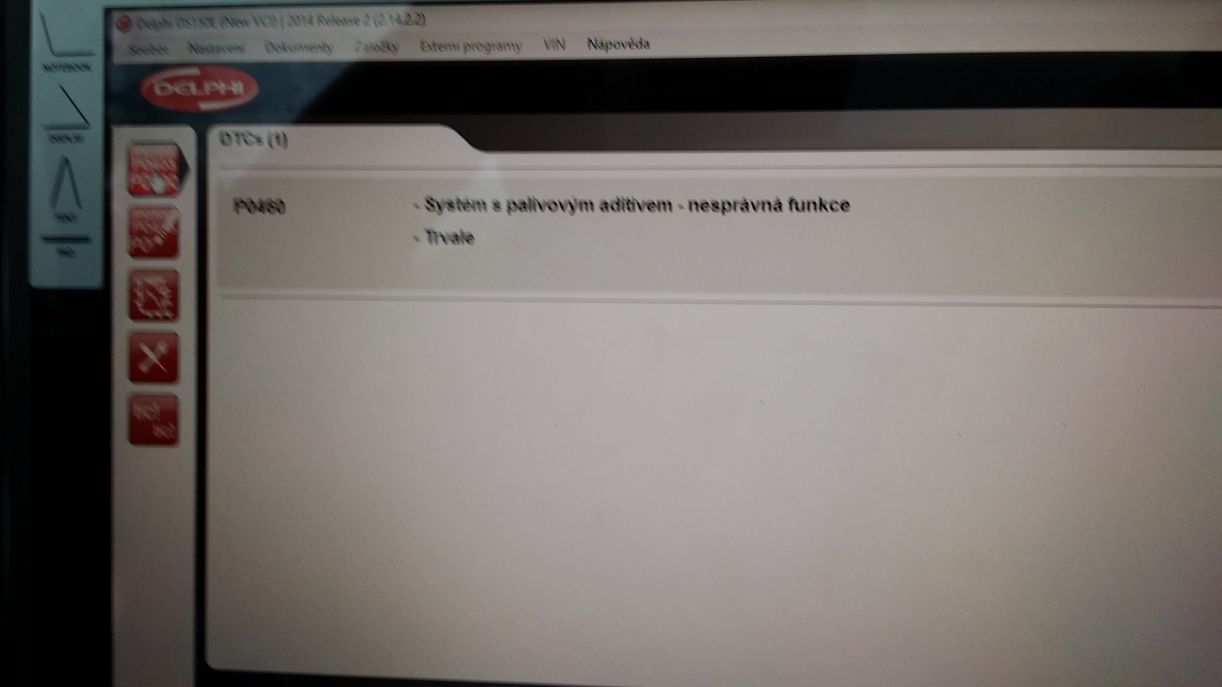

4_0_7sw Posted September 8, 2016 Share Posted September 8, 2016 Ahojte, na diagnostike mi vypisalo chybu - SYSTEM S PALIVOVYM ADITIVEM - NESPRAVNA FUNKCE - TRVALE. Mam Peugeot 407sw,r.v.2006,2.0HDI,100KW. Co to znamena a co s tym? Dakujem Quote Link to comment Share on other sites More sharing options...
Marcel00 Posted September 8, 2016 Share Posted September 8, 2016 cislo chyby napovie viac Quote Link to comment Share on other sites More sharing options...
4_0_7sw Posted September 8, 2016 Share Posted September 8, 2016 Před hodinou, Marcel00 napsal: cislo chyby napovie viac uuuuu, som si to odfotil ale fotka je rozmazana......je to bud P0480 alebo P0460. Quote Link to comment Share on other sites More sharing options...
4_0_7sw Posted September 8, 2016 Share Posted September 8, 2016 FOTO Quote Link to comment Share on other sites More sharing options...
ferinko2 Posted September 8, 2016 Share Posted September 8, 2016 P0460 Fuel Level Sensor Circuit Malfunction..... Ukazuje ti stav paliva v nádrži ? Ak je porucha,že ti stav paliva neukazuje....tak by som hľadal príčinu tam. A ešte snáď aj snímač zátky nádrže by sa do toho mohol zamontovať.Potom RJ nevie že bolo dotankované a zosnímať množstvo paliva pre určenie dávky aditíva. Quote Link to comment Share on other sites More sharing options...
4_0_7sw Posted September 9, 2016 Share Posted September 9, 2016 před 11 hodinami, ferinko2 napsal: P0460 Fuel Level Sensor Circuit Malfunction..... Ukazuje ti stav paliva v nádrži ? Ak je porucha,že ti stav paliva neukazuje....tak by som hľadal príčinu tam. A ešte snáď aj snímač zátky nádrže by sa do toho mohol zamontovať.Potom RJ nevie že bolo dotankované a zosnímať množstvo paliva pre určenie dávky aditíva. Stav paliva mi ukazuje,tak myslim ze by to mohol byt ten snimac zatky nadrze.Taky snimac nadrze zozeniem kde?okrem peugeot servisu. Quote Link to comment Share on other sites More sharing options...
vozzyn Posted September 9, 2016 Share Posted September 9, 2016 jenom v peugeotu, v sobotu si pro něho taky jedu. Cena 1150kč, ale jsou 2 typy, levnější a dražší. Quote Link to comment Share on other sites More sharing options...
ferinko2 Posted September 9, 2016 Share Posted September 9, 2016 Dal by som to na origo diagnostiku a potom čosi kupoval. Quote Link to comment Share on other sites More sharing options...
